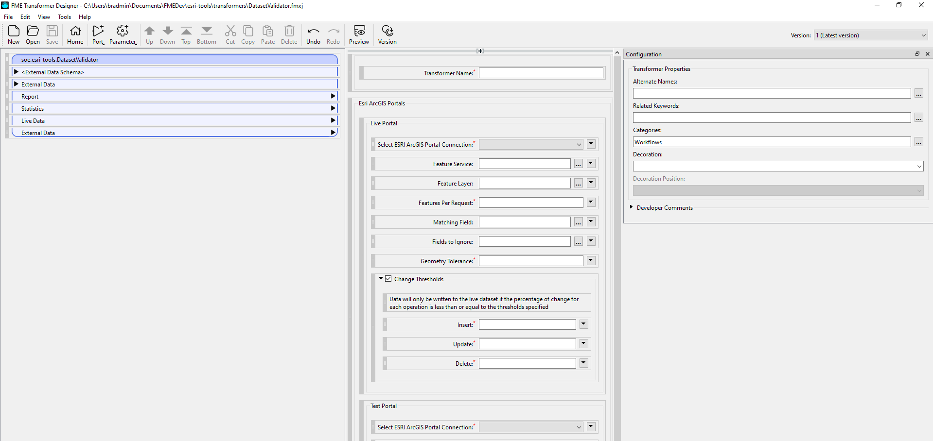

Hi ​@crystalatsafe
We are using neither of these transformers in our workspace. We have created this transformer using the Transformer Designer.
The execution instructions for the transformer uses the PythonFactory
FACTORY_DEF {*} TeeFactory
FACTORY_NAME { $(XFORMER_NAME)_ExternalData_CATCHER }
$(INPUT_ExternalData_LINES)
OUTPUT { FEATURE_TYPE $(XFORMER_NAME)_ExternalData_READY
@SupplyAttributes(___XF_VERSION, 1)
$(FME_PARM_VAL_LIST)
FACTORY_NAME { $(XFORMER_NAME)_ExternalSchema_CATCHER }
$(INPUT_ExternalSchema_LINES)
OUTPUT { FEATURE_TYPE $(XFORMER_NAME)_ExternalSchema_READY
FACTORY_DEF {*} PythonFactory
FACTORY_NAME { $(XFORMER_NAME)_DATA_PROCESSOR }
PY_INPUT_TAGS { ExternalData ExternalSchema }
INPUT { ExternalData FEATURE_TYPE $(XFORMER_NAME)_ExternalData_READY }
INPUT { ExternalSchema FEATURE_TYPE $(XFORMER_NAME)_ExternalSchema_READY }
SYMBOL_NAME fme_datasetvalidator.transformer.DataProcessor
PY_OUTPUT_TAGS { Report Statistics ExternalData LiveData }
OUTPUT { Report FEATURE_TYPE $(OUTPUT_Report_FTYPE)
@RemoveAttributes(fme_regexp_match,^___XF_.*$)
$(OUTPUT_Report_FUNCS) }
OUTPUT { Statistics FEATURE_TYPE $(OUTPUT_Statistics_FTYPE)
$(OUTPUT_Statistics_FUNCS) }
OUTPUT { ExternalData FEATURE_TYPE $(OUTPUT_ExternalData_FTYPE)
$(OUTPUT_ExternalData_FUNCS) }
OUTPUT { LiveData FEATURE_TYPE $(OUTPUT_LiveData_FTYPE)
$(OUTPUT_LiveData_FUNCS) }
It is within our python script located at fme_datasetvalidator.transformer.DataProcessor that we create reader object using FMEObjects.FMEUniversalReader fmeobjects.FMEUniversalReader — Python FME API FME 2024.2 b24791 documentation to read features based on the transformer parameters. The features are then output using pyoutput to the ‘LiveData’ port.
It looks like as we are reading features only within the transformer rather than have them passed through the transformer they are output with unexposed attributes.
Thanks for taking the time to take a look at this for us, please let us know if there is any other information we can provide.
