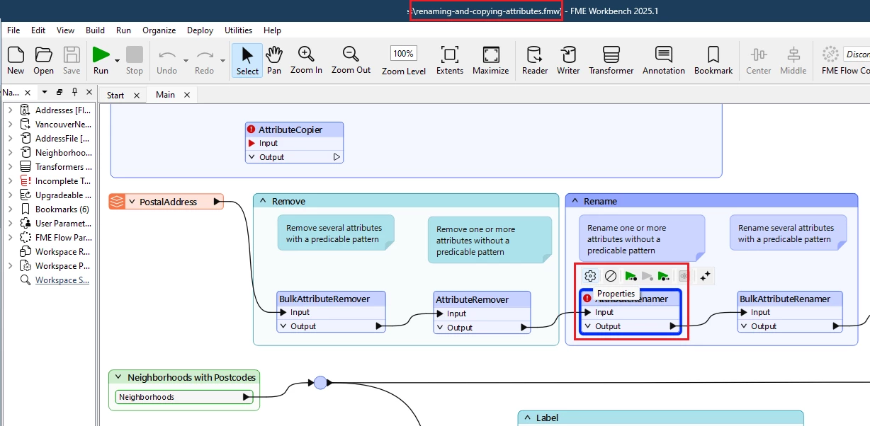

Whenever I try to open the AttributeRenamer transform properties, FME Form crashes.

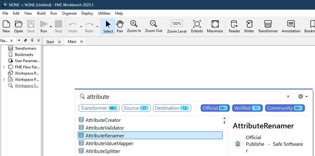

It doesnt matter if it is an existing workflow or if I start a new one woth nothing but only one AttributeRenamer.
Any thoughts, anyone?
The screenshot below if from FME Academy:
But it also happens on an otherwise empty workflow:

In the second screenshot you have a BulkAttributeRenamer rather than an AttributeRenamer. Does both cause this problem?
What about the AttributeManager, does that work? It can fully replace the AttributeRenamer, at least.
Which OS are you on? Is the OS updated with all the latest patches? It could be that the issue is with the graphics driver, make sure it’s updated.

Yes, it happened to both renamers. If fact, it just crashed when I tried to add a new AttributeRenamer to the workflow above using the menu that opens when you type AttributeRenamer on the canvas.
