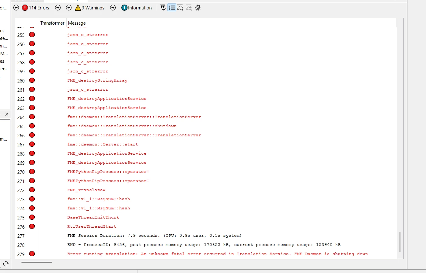

Now i want to do it with an Feature Writer set to Microsoft Excel, but when i run the feature writer with, i believe, the same settings as the Excel writer, it results in a fatal error, where it states FME daemon is shutting down.
Can anyone help me? That would be greatly appreciated. Thanks!
Error log Translation

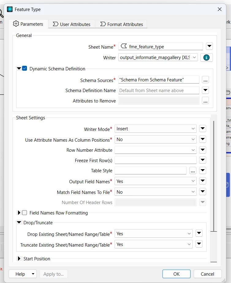

Other settings are default.

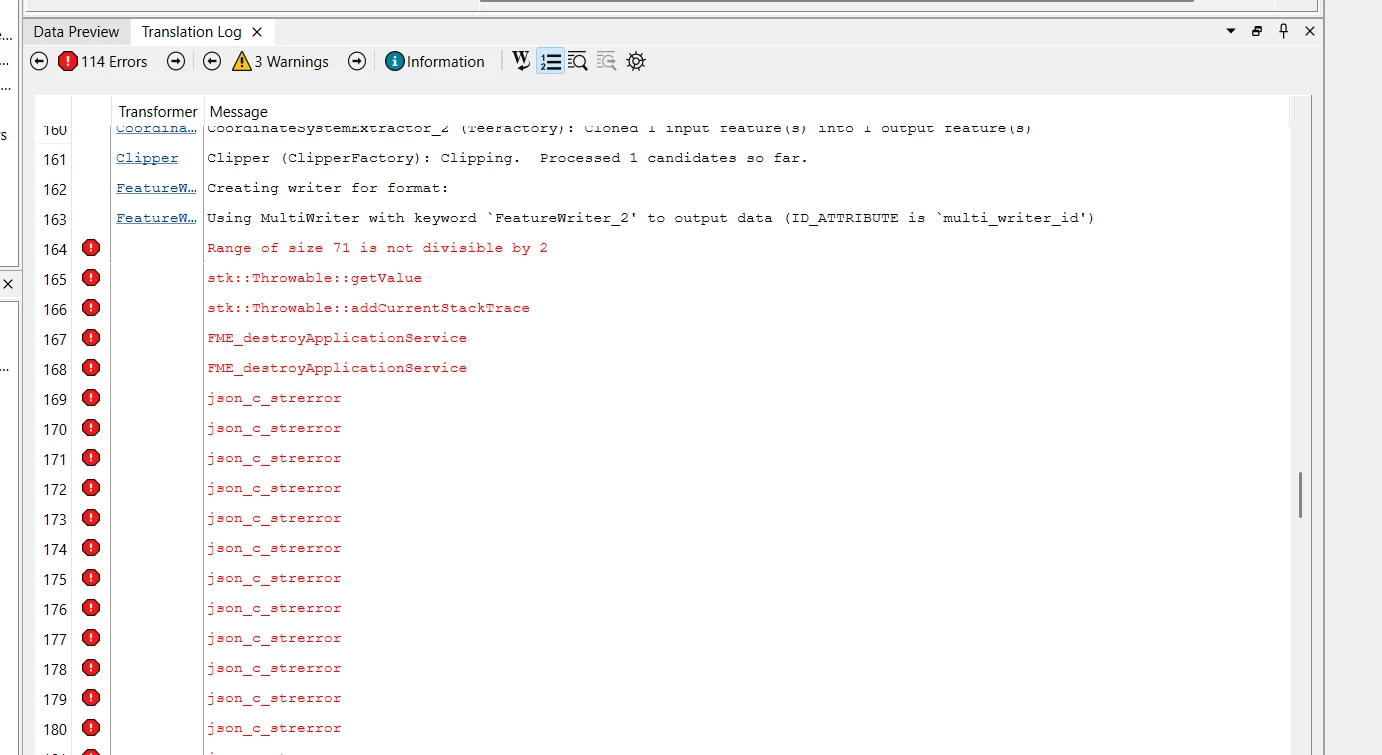

Interesting here: number 164. I dont know why of what.

This one looks like a bug to me - the kind’s of ERRORS you’re seeing there are not intended for a user. If it was me I would submit something via Safe Support which they can use to reproduce the issue.
The divisible by 2 error though and the fact you’re using a schema feature to define the schema could suggest that it’s related to the schema. Total wild guess, however, if you’re doing anything to the schema feature at all you might want to take a look to see if something is getting dropped somewhere.
Are you able to play round with the settings at all to narrow down the crash?
