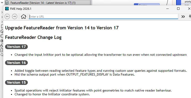

You might want to check upgrading versions of Feature Reader. Here is a snapshot of 14 to 17 change log

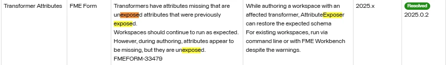

I haven’t seen this myself, but I can see there were other transformer with expose/unexposed bugs
Can someone from Safe please check this over.
