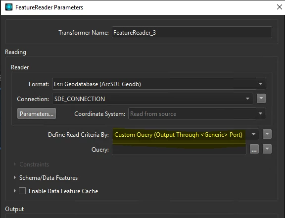

Looking at the new Define Read Criteria By: Custom Query option in the FeatureReader in 2025.1
I feel like there should be a warning against using Define Read Criteria with Esri Geodatabase format as it uses sql and bypasses specific SDE functionality.

Initially I noticed that the resolve domains option wasn't respected when using Define Read Criteria.
Then I tested against a feature class that has archiving turned on.
A simple where clause returns just the current feature, using a query in the Define Read Criteria returns both the current and a historic feature.
