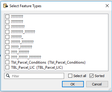

I am traying to read this bellow wfs , I trayed all combination on configuring the wfs reader but still giving me the error ( Failed to obtain any schemas from reader 'WFS' from 1 datasets. This may be due to invalid datasets or format accessibility issues due to licensing, dependencies, or module loading. See logfile for more information)
twe could open the URL on browser and also we could read it on ArcMAP
http://webgis.eamana.gov.sa/arcgisnew/services/BASEMAP/MapServer/WFSServer?request=GetCapabilities&service;=WFS

I think the problem could be the name of the layers. FME seems incapable of reading them properly. It only shows a lot of question marks.
@boubcher I concur here that FME seems to be unable to read the Arabic names in the text. I will follow up with you and file a request for our development team.
