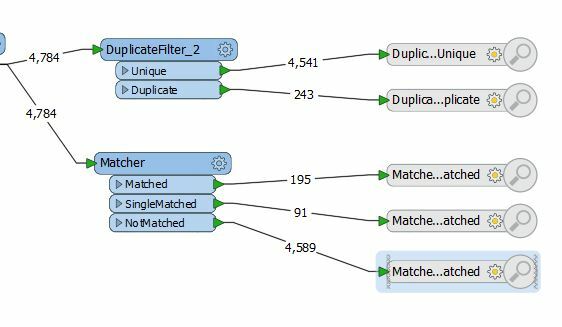

I am getting different results on the duplicates from DuplicateFilter and Matcher.
They are both matching on the same attributes.
The filter is stating that there are 243 duplicates so there must be a number which are the unique matches. The mather is only matching 195 on the same attributes.

Make sure that the Match Geometry parameter in the Matcher is set to NONE.

Thank you Takashi, That seems to work.
