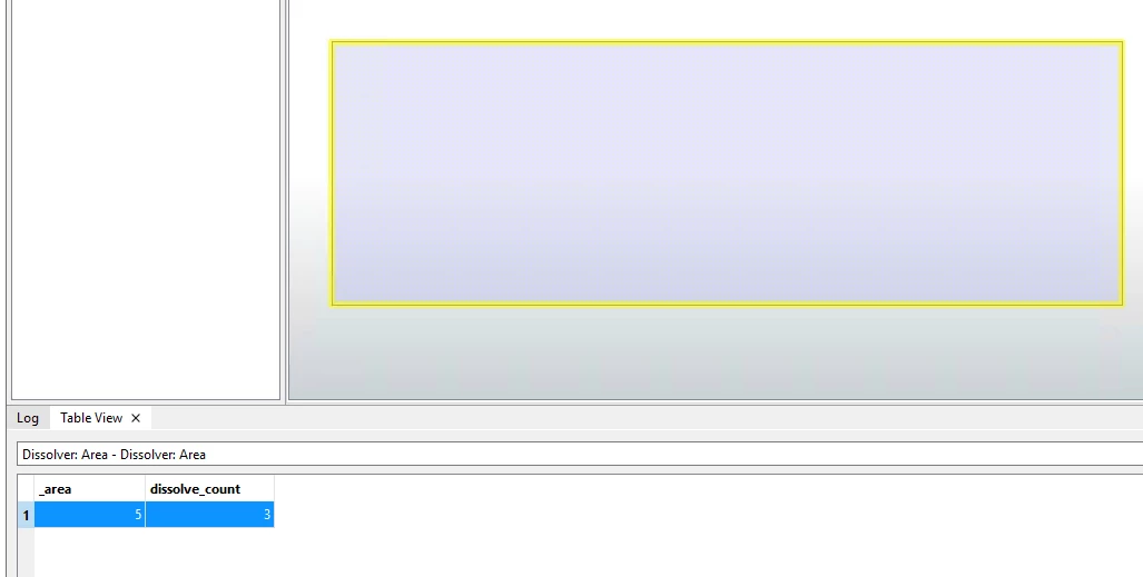

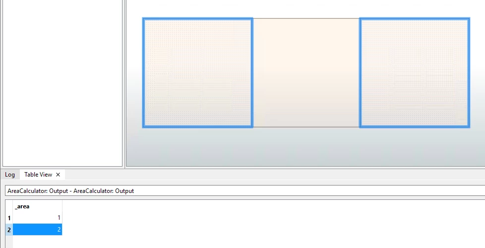

So from this
You get this

I’ve used area in this example, but in my case, I was summing other attributes that cannot just be easy recalculated post dissolve.
