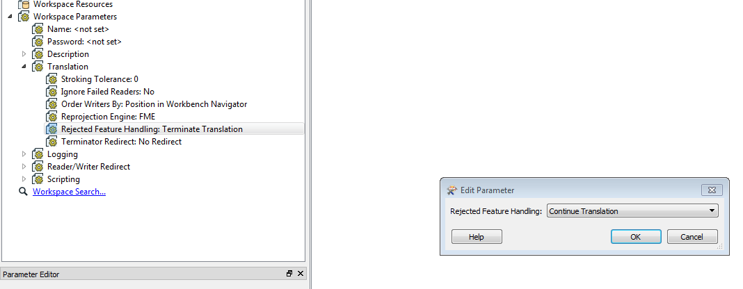

@gio,
What about changing the workspace parameters on how the rejected features are handled?
It will still say that you have extra reference features, but it wont terminate your translation and you wont need to add a disabled inspector.
