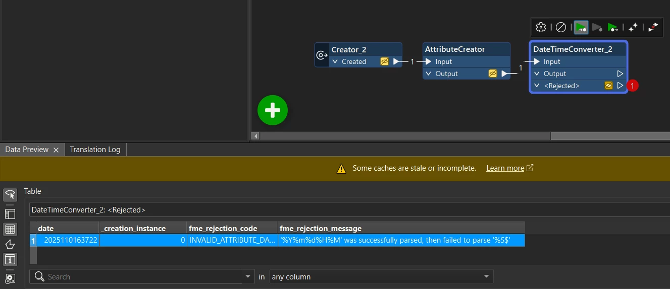

I am curious as to how you are able to convert your FME datetime (2025110163722) to UNIX epoch time. Your value corresponds to 2025/11/01 6:37:22, but the hour component 6 is not zero-padded to 06. This makes your FME datetime string technically invalid (since 63722 does not resolve to a valid HHmmss). Here is a screenshot showing that your value cannot be parsed by DateTimeConverter:
When modifying the value to 20251101063722 (with the zero-padded hour), then using DateTimeConverter to UNIX epoch seconds and using AttributeManager to convert this value to UNIX milliseconds (1761979042000); the date value I see on the feature service is 10/31/2025 11:37:22 PM (Esri applies the timezone offset; I am located in Safe headquarters in Surrey, BC which is UTC-7) which corresponds to 2025/11/01 6:37:22.
