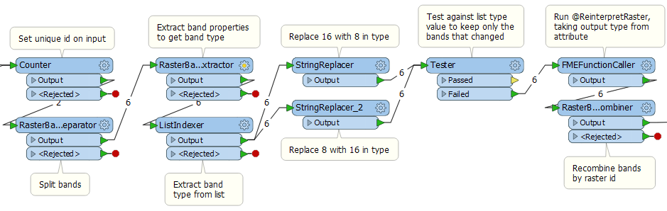

The RasterBandInterpretationCoercer uses the function @ReinterpretRaster. If we run this function in the FMEFunctionCaller transformer, we gain the ability to set the output raster type from a feature attribute.
We can use the RasterBandPropertyExtractor to determine the band type, then map that to its output type in a new attribute for the function.
I am attaching a workspace to illustrate the process.
changerastertype.fmw
