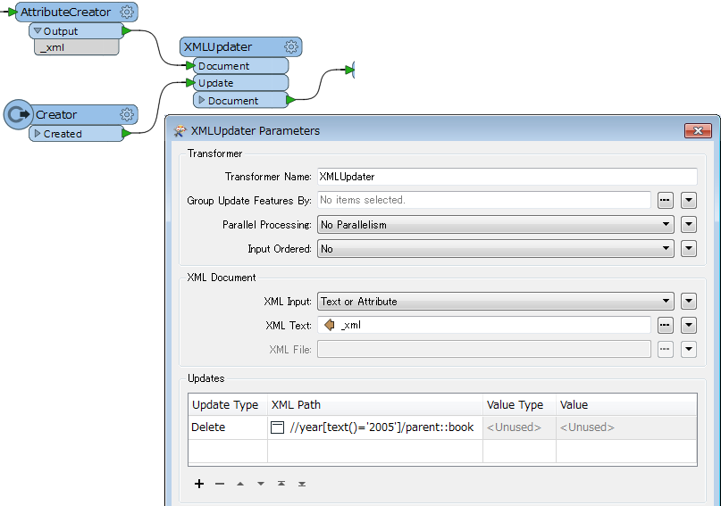

Best answer by takashi
Hi @mario_bla, the XMLUpdater might help you. Note the XMLUpdater always requires a feature input from the Update port, although it's not necessary that the feature contains any relevant attribute in this case.
XML Path setting:
//year[text()='2005']/parent::book
Alternatively, the XMLXQueryUpdater can be used.
XQuery Expression
delete node //year[text()='2005']/parent::book
XML Path setting:
XQuery Expression

Hi @takashi,
thank you very much for your help! I managed to do it following your first suggestion with XMLUpdater. It took me a while because I was always using xml reader and couldn't make the XMLUpdater to do its task. Than I used the txt reader instead and read the xml file as a plain text (with parameter 'read whole file at once' set to 'yes'). When I did that, workbench ran successfully.

Good to hear.
Additions.
1. You can also read the source XML file with the XMLUpdater directly.
2. This XPath is also available in your case.
//book[child::year/text()='2005']
