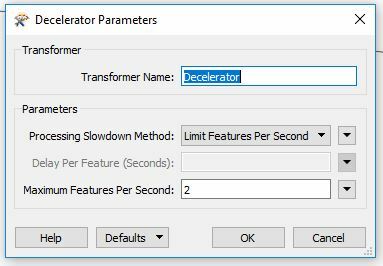

I have a decelorator in my routine but it is failing with the message below. It looks like it is failing within the transformer.
@Tcl2 -- failed to evaluate expression `if { {Limit Features Per Second} == {Per Feature Delay} } { rename Decelerator_delay Decelerator_Waiter; } else { rename Decelerator_maxpersecond Decelerator_Waiter; };' -- can't rename to "Decelerator_Waiter": command already exists
Any ideas how I can get it going?
Thanks

How have you defined the Decelerator parameters? Can we get a screenshot?

Sorry, I thought I had posted the screen shot.
There are very few settings that can be altered.
david_r
  • May 17, 2018 3:08 PM UTC
Thanks for posting the screenshot, the settings look perfectly normal to me.
Can you try deleting the transformer from your workspace and then inserting it again?

Have you used an attribute for the Maximum Features per Second setting?
If so, Is that attribute in all cases a valid integer.
If not, that could cause this issue.
I would recommend an AttributeVallidator transformer to check if the value is of type Integer before handing the attribute to the Decelerator.
I ahve delted and reentered it a few times. I have also tried updating FME to the latest version as well but no joy.
It is just typed in as the number 2.

Hi @sebkingsley -- sorry to see that you have somehow stumbled into a situation that would seem to be impossible. So we have a bug on our hands. The "good" news is that it has stayed that way for you. Could you send your workspace in to support@safe.com and reference this posting in your note?
The error is due to somehow there already being a "Decelerator_Waiter" function in place in FME's internal Tcl subsystem. I check how this is written and do not see how it is possible for this to happen. So that is why your original workspace is so important for us to be able to look it.
So please send it.
And after you do...a most probable workaround would be to rename the Decelerator transformer to have a different name. Then it will be trying to rename the function to YourName_Waiter instead. And I suspect it would work then. But please send us the broken workspace first! Thanks and sorry.
