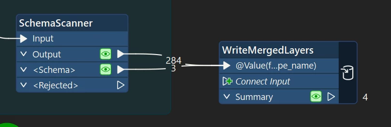

I have a workbench that takes data from Oracle, merges it with a few other tables, runs it through a schema scanner and then tries to output to a file geodatabase.
The file geodatabase has the merged table created but it only contains the schema definition not the data.

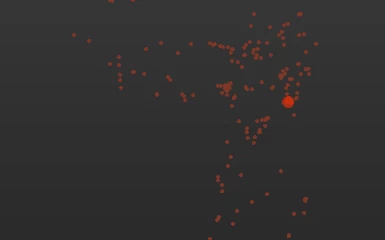

The output from the schema scanner shows the points in the graphics display.

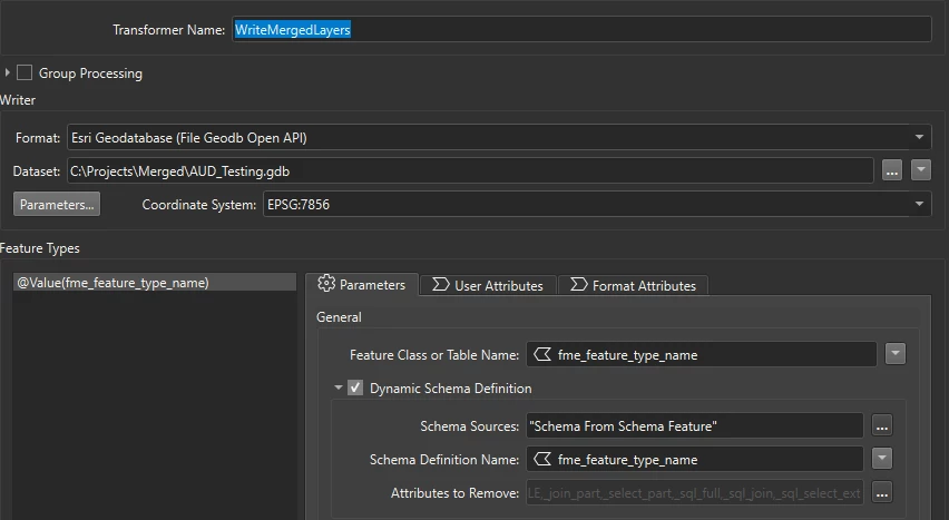

These are the transformers that scan and output

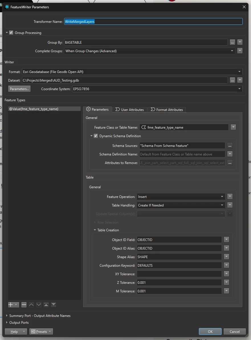

Here is the Feature Writer

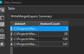

The summary is showing the feature count
There is some disconnect between the schema scanner and my output and was hoping someone might be able to see what I am doing wrong.
The workbench is attached. Any assistance would be greatly appreciated.
Best answer by deanhowell
Thanks ​@davechoi from ​SAFE as the big issue was grouping.
Turn off the Group Processing and add ‘fme_feature_type_name’ in the schema definition

Are you seeing any errors or warnings in the log?
Your writer setup looks okay (without opening up the fmw) Maybe try setting the featureclass to fme_feature_type and the schema definition name to fme_feature_type_name (as per Dynamic Workflows with the SchemaScanner – FME Support Center)

Thanks ​@hkingsbury I see the following a couple of times. It writes the blank schema to the GDB but just doesn’t create the data.
Cannot define schema for 'CAP_PT' as the feature does not contain schema information, and schema source is set to 'Schema from Schema Feature'. Please verify writer feature type configuration
Writer `WriteMergedLayers_0' of type `FILEGDB' using group definition keyword `WriteMergedLayers_0_DEF'
FileGDB Writer: A feature with feature type `CAP_PT' could not be written
Storing feature(s) to FME feature store file `C:\Projects\Workbenches\ArcGISPortalFromOracle_log.ffs'
