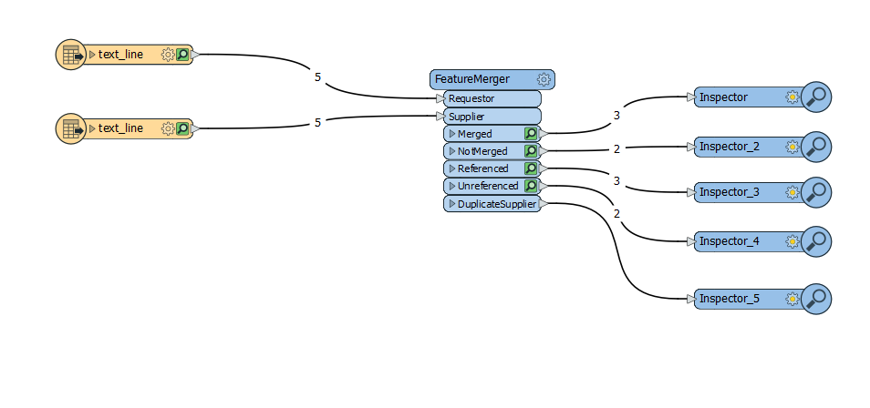

Hello,
I have recently upgraded from version 2016 to newest version 2019. I noticed some strange behavior of 'Save data as' functionality in Data inspector in new version.
When I want to make some quick 'one time' procedure to check something and don't want to lose to much time for polishing, I usually just add Inspector and later if needed export the results from inspector to excel...
For example, I have 2 txt files, one containing data: 1 2 3 5 7 (each in its own row), and the other containing data 1 3 7 8 9 (again each in its own row). I want to match those data and inspect the differences:
Everything works well but when I open Data inspector and want to save the data to excel I get this error:
Feature Type: `Inspector'
Attribute(string): `text_line_data' has value `varchar(255)'
Attribute: `text_line_data' is sequenced
Geometry Type: Unknown (0)
Number of Coordinates: 0 -- Coordinate System: `'
In old 2016 version it worked ok and I could save to excel from Data inspector. What is the reason this doesn't work any more? Or, how to make it to work again - what is the error message implying?

Thank you very much for your comment. If I may ask, what build are you using? I have tried in last two newest: 19813 (219.2.1.0) and 19801 (219.2.0.0) and have the same error. But for example, in build 19630 (219.1.2) this error doesn't occur (works like in older 2016 version).
I know that this is probably not the best approach to use inspector for this but this is only for small and 'dirty' procedures which I run only once just to get the general idea about data and don't even bother to save them after I use them. I can live without this functionality - the question is only is this a bug or there is some explanation or setting I have to apply to make this work like before.
I have also noticed that this error only happens when there is more than one or two inspectors. In most cases it works ok with only one inspector, even two in some cases (didn't figure out the pattern or rule yet)... With more inspectors it doesn't work.

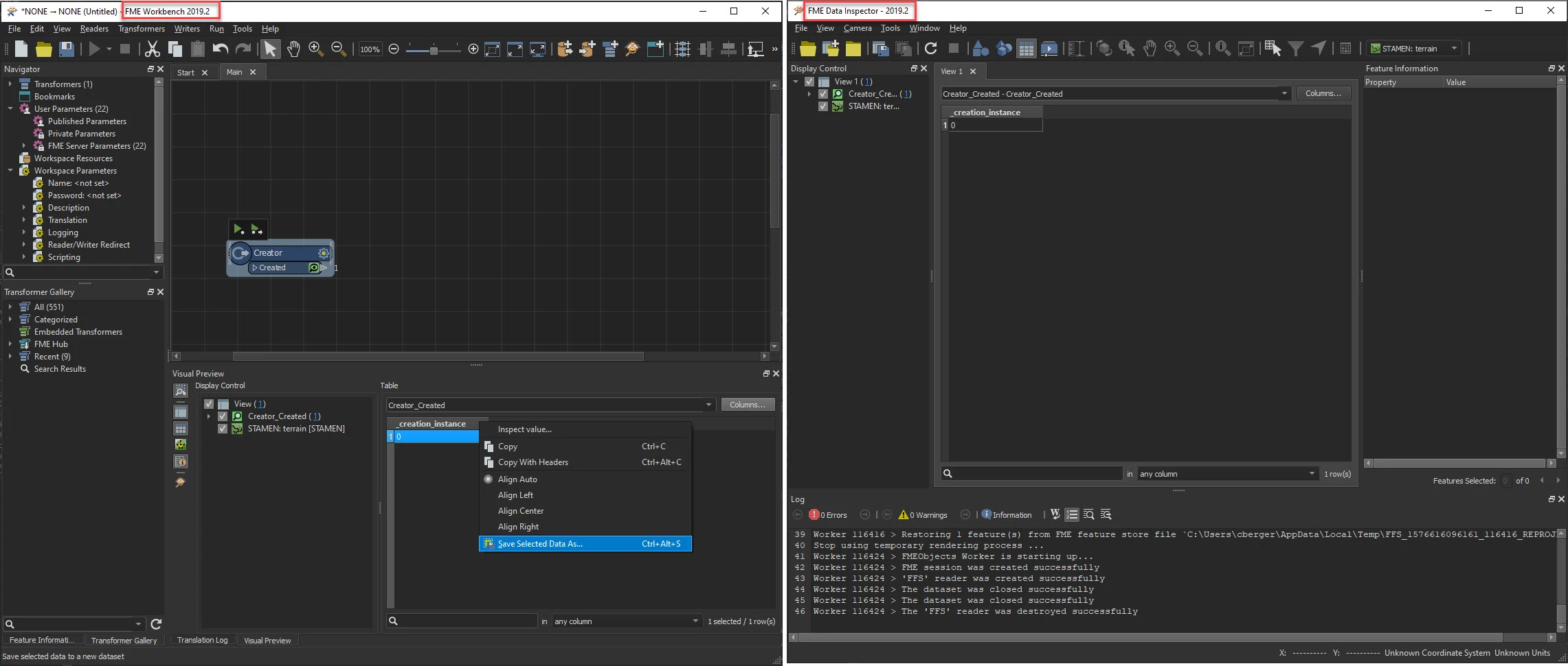

Hi @mario_bla,
Just wanted to clarify if this behavior is with the FME Data Inspector application or the visual preview window within FME Workbench? Or do you get the same error in both Data Inspector and Visual Preview?

Hi @chrisatsafe,
I just tried and confirmed that I get the same error both in FME Data Inspector application and the visual preview window within FME Workbench.

Hi @mario_bla,
This is an interesting one! We had another user report similar behavior with build 19813 but it is proving to be a tricky one to reproduce. I haven't been able to reproduce locally or on a VM. Just to confirm, does this still occur after purging your temporary files (Tools > Purge Temporary Files)?
Would you be able to help us get a better understanding of your machine by running the system_information.bat file from the General Troubleshooting Guide and sending the resulting FMEReport.html file to our support team by submitting a case so we can continue to look into this for you?

Hi @chrisatsafe,
Purging temporary files doesn't help.
I have followed your suggestion and submit a case. Case number is C150836.
