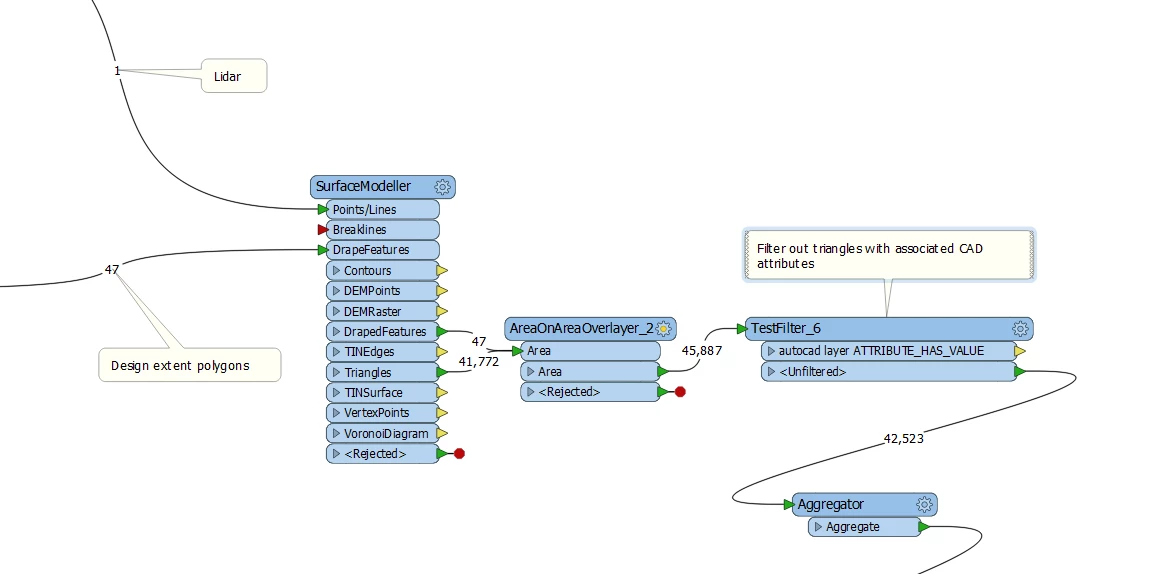

Hello. I have a similar approach you could try using the AreaOnAreaOverlayer with draped features and surface triangles which works quite nicely
Thank you Owen
