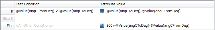

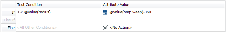

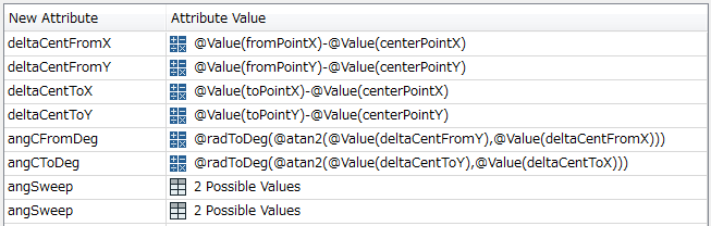

Hi @katrinaopperman, it seems that positive radius indicates CW and negative radius indicates CCW. If so, these math expressions compute your desired arc properties.
angSweep (1) Calculate sweep angle from "from" to "to" in CCW.
angSweep (2) If the radius is positive, modify the sweep angle into CW orientation.

  • May 20, 2018 7:11 AM UTC
