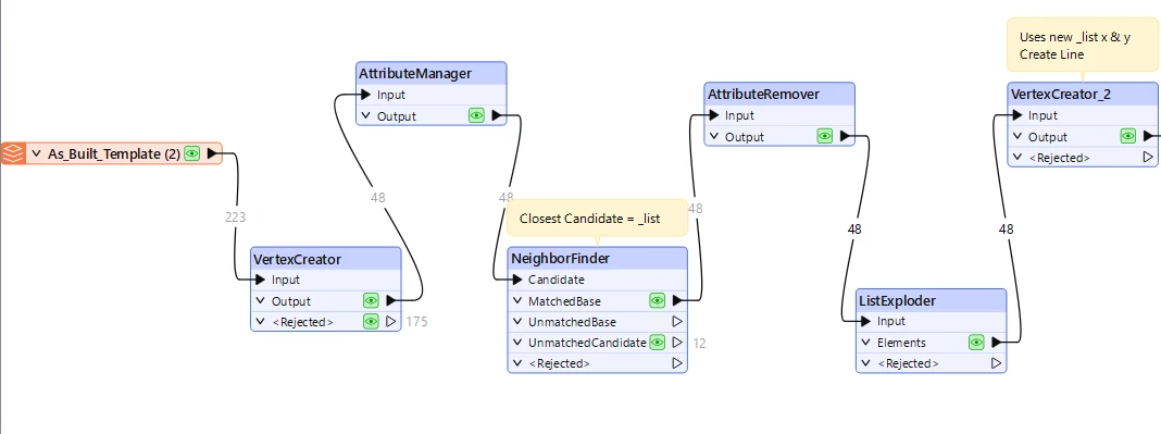

I have a spreadsheet that has 50 rows of data including Lat/Longs. Each row is considered a pipeline segment. I would like to create a segmented line. I found a post that recommended NeighborFinder, ListExploder and VertexCreator to accomplish this.  My line comes out with gaps. I have tried all options I can think of for the LineBuilder, but I only get one line or it still outputs points.
Output:
What am I missing?

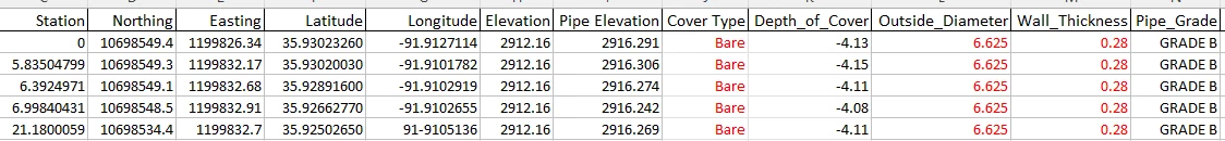

Hi ​@hriordan What does a sample row from the spreadsheet look like?  Does it define the entire line or just a segment of it?  Is a segmented line an aggregate or a path?
Thanks,
Dan
hriordan
Forum|alt.badge.img+12
  • Jun 10, 2026 12:03 PM UTC
​@DanAtSafe The spreadsheet is in segments, but only contain on set of lat/long. Here is a snipet.

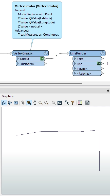

Assuming the points are in the correct order: Use a VertexCreator, followed by a LineBuilder.
hriordan
  • Jun 10, 2026 2:03 PM UTC
​@geomancer Thanks, but I believe that will only create one, nonsegmented, line.  I am hoping to preserve the segments.

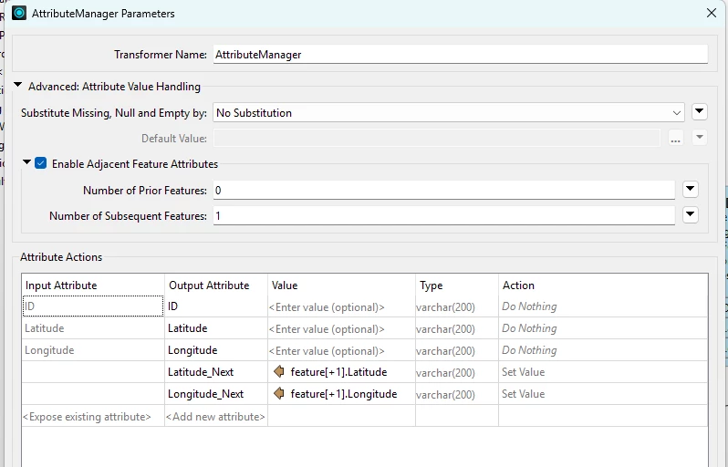

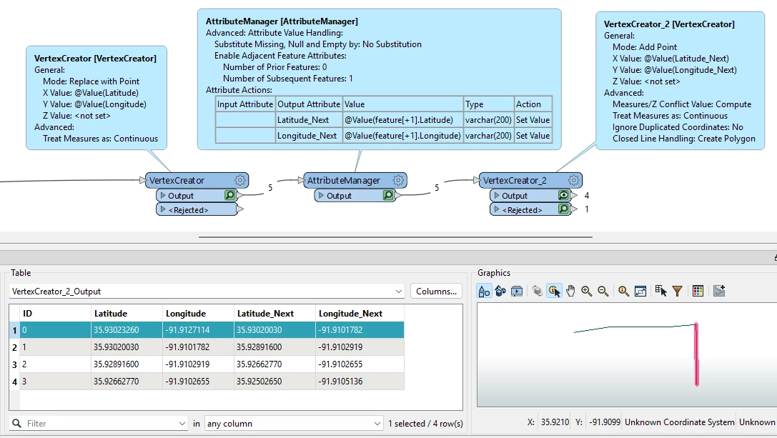

I see my NeighborFinder is not producing the results needed to create that 2nd point. I can make it work if I edit the xls to add a ToLatitude and ToLongitude fields. I then set my VertexCreator2 to that new field.  I am hoping to limit the amount of editing that needs to be done to the xls.
geomancer
Forum|alt.badge.img+71
  • Jun 10, 2026 2:32 PM UTC
FME can add those extra attributes for you, using ‘Adjacent Feature Attributes'.
(Edit: added workspace)
hriordan
  • Jun 10, 2026 2:55 PM UTC
That did it!  Thank you!
