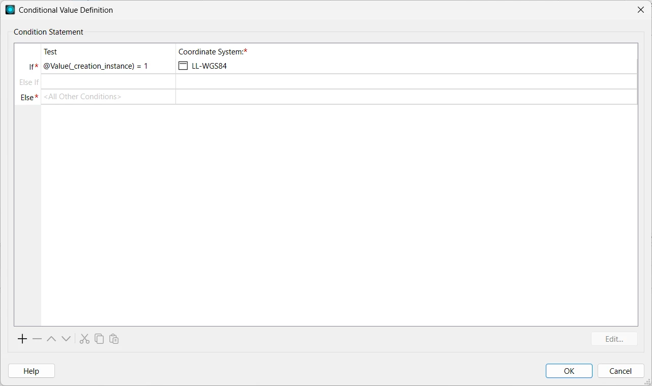

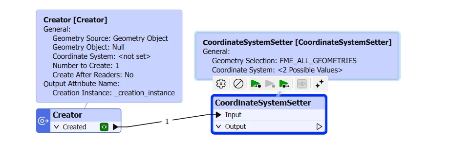

I just have a simple test as follows:
Β
And I have tried some conditional value at test statement but always get error:
β€œCoordinateSystemSetter (CoordinateSystemFactory): CoordinateSystemSetter: Invalid Test Expression: TEST@Value(_creation_instance)=1”
β€œCoordinateSystemSetter (CoordinateSystemFactory): CoordinateSystemSetter: Failed to evaluate input expression: FME_CONDITIONAL:DEFAULT_VALUE''BOOL_OP;OR;COMPOSITE_TEST;1;TEST@Value(_creation_instance)=1'LL-WGS84'FME_NUM_CONDITIONS2___”
β€œError running translation: CoordinateSystemSetter: Invalid Test Expression: TEST@Value(_creation_instance)=1. CoordinateSystemSetter: Failed to evaluate input expression: FME_CONDITIONAL:DEFAULT_VALUE''BOOL_OP;OR;COMPOSITE_TEST;1;TEST@Value(_creation_instance)=1'LL-WGS84'FME_NUM_CONDITIONS2___”

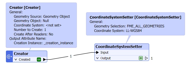

It only works with fixed-value coordinate systems:

That’s really strange. So yesterday when I said I tried it, I had used a User Paramter rather than an attribute value. Trying to recreate what you have and I’m getting the same errors.
Some things to look out for:
  • If you let the Creator create just one feature, it’s _creation_instance will be 0. I changed that in the conditional value, no change.
  • You’re currently creating a null geometry, I thought that that might throw the CoordinateSystemSetter off, but adding geometry doesn’tΒ make a difference.
  • You’re not adding a coordinate system to the Else part, I also tried that and no difference.
I also tried your setup but with a user parameter and that doesn’t work either all of a sudden...
I think you’re right and this may be a bug. Your best course of action is to submit this as a support ticket with either your local partner or Safe directly and refer them to this discussion.
