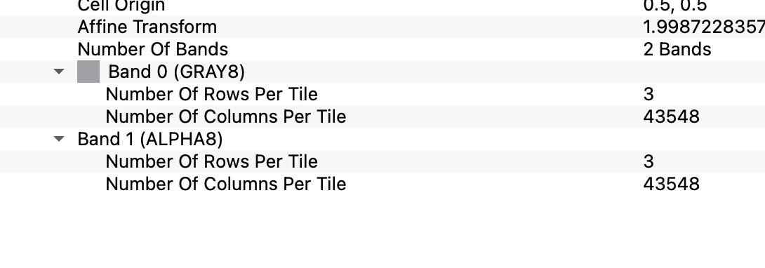

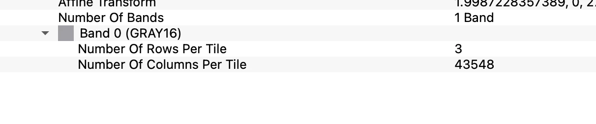

I am not getting this to work. Might be a setting or something. Seems that the Alpha band does not get “reactivated”, only band 0 (grey16) comes out the other end.
My settings:
Incoming raster:
Processed raster:
