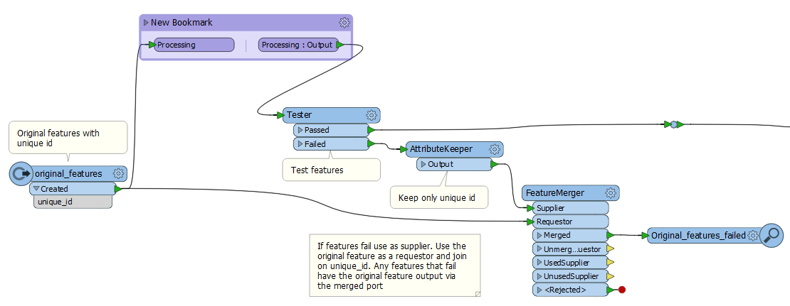

I have built a workbench where I do some processing on a set of features and then test the result. If the result is not what I want I would like to go back to the original feature and send it down a different path. How do I do this? I know how to find duplicates, set counters and such, but how can I compare the attributes from features in two separate "data streams" and then output one of those "streams"?

Will this sort of flow work for you? Features that pass continue in the workspace, if there is a failed feature, the original feature comes out of the merged port of the FeatuerMerger
