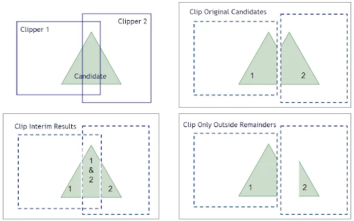

The first and second of the above outputs are expected, but the third forms a donut with the smallest polygon. I’ve tried many different settings and followed what guidance there is but I cannot understand why this donut is being created.
Of the below image I would expect an output similar to Clip Original Candidates. This is the setting I’ve used for my clipper.
It seems as though the clippers are clipping each other, or the Clip Original Candidates setting is only applying to the first input clipper.
