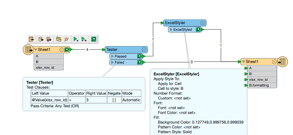

Workspace:

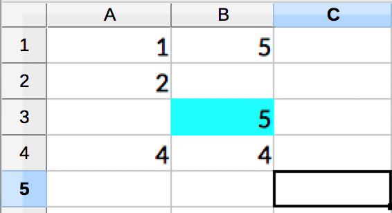

Output:

Workspace:
Output:

Hi @hollyatsafe,
This does indeed work, and in reality I already did it the way you suggested before I even posted this question.
My issue was that my writer was set on manual, so the attributes like "C.formatting" was not being preserved. I guess that is the confusing part, that those invisible attributes need to be present, because just adding "C" to the output keeps generating unformulated sheets.
