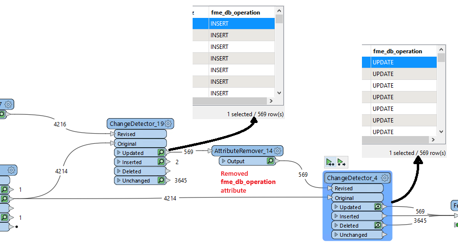

Comparing features using a ChangeDetector transformer I see a weird behaviour. It does not always happen though but can’t see a pattern.
I see features correctly output though Updated and Inserted ports but all of them have value ‘INSERT’ in fme_db_operation attribute. Has anyone experienced something like this?

@crutledge I did set the Update Detection Key Attributes because I want to detect changes on features based on a unique key. That’s why I don’t understand the behaviour I mentioned, which is quite random I think.

Hi ​@dms2 I follow you now. From what you describe I would expect Update not Insert too. I see the one changedetector is _19 and the other is _4. Have you tried deleting that _19 and using a fresh change detector? If you delete that _19 change detector does the next change detector _4 output Insert instead of Update? The IDs are the same fields in both? This is a new workbench or customizing an existing one? The transformers are the same version?

I added the that _4 ChangeDetector to test whether my suspicions about the ChangeDetector transformer were right. I deleted that part and actually I rebuilt the whole flow trying to get the results I expected and knew were right for the current data. So I cannot check anything related to it.
What I can tell you is that the IDs were the same fields in both and the same version of the transformer.
