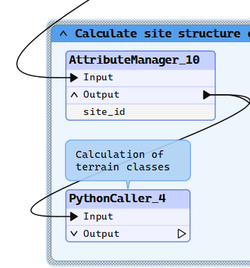

I tried to single out the problem in a minimal workspace (attached), but here it works without a problem. Hence, I am wondering how and what is causing the issue. The actual workspace is rather big and I will share a screenshot of the essential part that is failing.
The AttributeManager10 receives a single feature from the summary port of a FeatureWriter and in AttributeManager10 all other exposed attributes are deleted, except the site_id (integer) is kept. Unexposed attributes are there only two:
  1. fme_geometry -> fme_undefined
  2. fme_type -> fme_no_geom
Running to the Attributemanager10 works fine. The next partial run of PythonCaller_4 fails with:

How/where did you install the Python libraries? Did you install psycopg2 etc. in the high-level Python plugin folder, or inside a version-specific folder?
Have both workspaces been configured to use the exact same Python interpreter?
