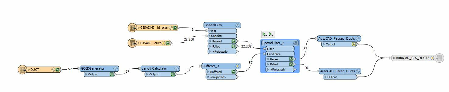

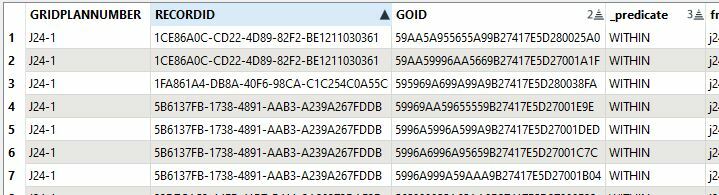

Hi,
I am trying to asses assets that are in CAD and not in GIS. Using the Spatial filter or the SpatialRelator i am getting results of one to many. I.e. the results are relating one candidate to many filters.
What transformer can i use that only spatial joins one candidate to only one filter?
Please help!

Hi, have you looked at the Matcher?

Just to be sure: did you remove the Bufferer?

Thanks - i tired that and still get no matches. The two sources are not identical. They are two systems drawn individually that i am trying to compare to see what is missing from one source. From what i understand Matcher is where they are identical so this transformer isn't working either.

The Matcher has a parameter" Vector Tolerance", which allows two geometries to have spatial variation and still be considered a match.
It would depend on the differences between the two sources whether this would work.

I just noticed you are trying to compare lines. Maybe the LineOnLineRelator from FME Hub can help you out. Note that this transformer requires FME 2022.2.0.0 (Build 22765) or higher.
