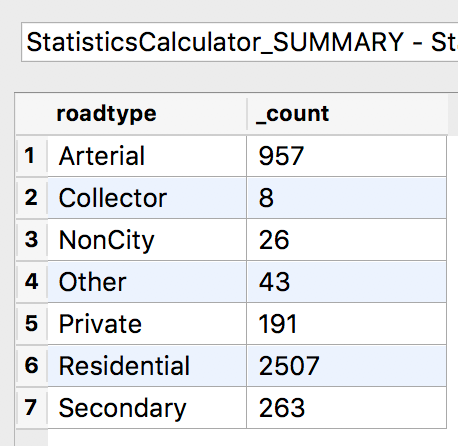

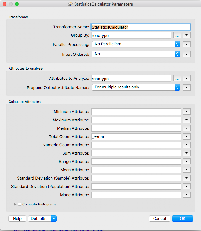

Hi @sebascote,
I think the StatisticsCalculator might be a better fit here - you can set the Group By to the RoadType attribute as well and then the Summary Port will give you what you are after:
Output:
Then you can use the Complete/Cumulative Ports to carry on with your data translation.
