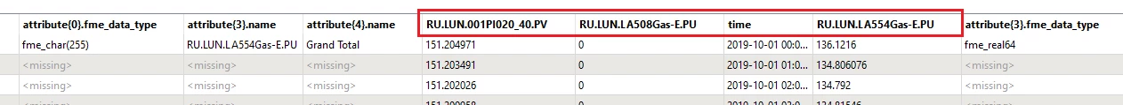

How can I write the selected attributes to CSV from AttributePivoter?
I don't know the names in advance it's a dynamic list of attributes.

If you don't know the attribute names beforehand, it can be done, but involves creating a schema within the workflow that can be used in the writer. It's not straightforward
