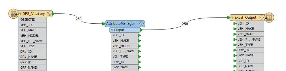

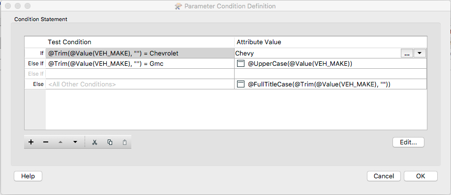

I am new to FME, so pardon the basic nature of this question. But I am trying to normalize my data.
Standardization of names, such as Chevrolet to Chevy. Remove a leading " " and change the case of words.
Here is what I have done:
It seems logical to me, but my output doesn't get applied to my excel:
Any help would be appreciated.

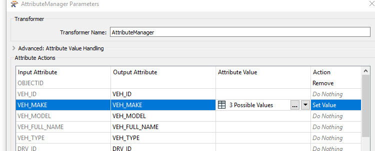

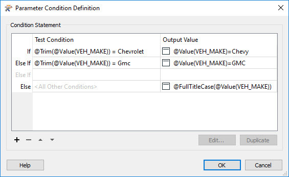

Hi @cquadrini56,
First I think it would be easier to use the AttributeTrimmer transformer to remove the quotation marks - rather than specifying @Trim multiple times - however if you do use this string function the format needs to be : Trim(str, [chars]), else if chars is not specified then only white space will be removed.
Second in the Output value you just need to specify Chevy/GMC - since the test is already finding only those with Chevrolet, with your current set up the output value would be 'Chevrolet=Chevy' rather than just 'Chevy'. The AttributeValueMapper is another transformer you could look at to do this.
This is the set up you would need in your AttributeManager:

Hi Holly,
I am sorry for not being clear, when I typed " " I meant a white space. Trim, nor the trimmer wanted to take it off. My excel output still had the leading space.
As fort he casing situation, I want the casing to be First letter of the word, unless it is an anagram, such as GMC, that was why my thinking said to call it out, but my logic could be flawed here, so anyway to do it is appreciated.

Note: I've used the @UpperCase function for the GMC value but you could just set the value to GMC as you did originally also.
