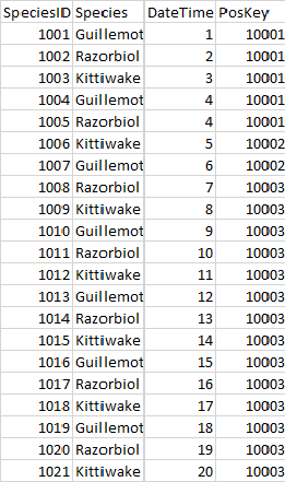

I have two tables below
This was done in excel, in essence, I want to assign the Pos_ID from the first table to the PosKey in the second table depending on the values on the date/time column on both tables.
Is there a way to do this in FME?
Thank you

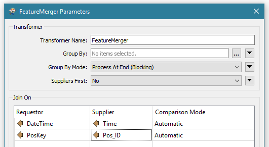

Would a FeatureMerger with the following configuration cover your use case?
Assuming that the "large" table is routed to the Requestor and the "small" table to the Supplier.

Hi
Thank you for your answer.
It did join the tables but it did not transfer the values but I guess this has to do with the values in my tables not being of the same type.
