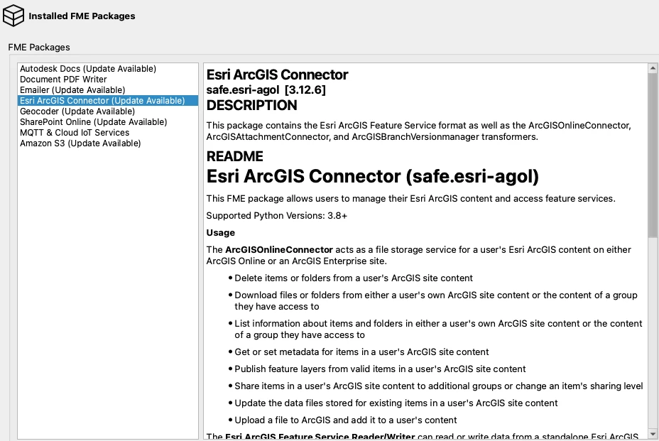

Check under Tools > FME options and find “FME Packages”
You might be able to ‘upgrade’ ArcGISOnlineConnector
 https://hub.safe.com/publishers/safe/packages/esri-agol

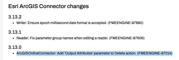

Down the bottom, hit upgrade to get something newer than 3.13 release which has a fix you’re probably looking for
https://support.safe.com/hc/en-us/articles/25407474895629-How-to-Create-an-ArcGIS-Online-Web-Connection-OAuth-2-0
  • As of FME 2024.0, support for Esri ArcGIS Online (AGOL), ArcGIS Enterprise Portal, and ArcGIS Server Feature Services has transitioned to a unified approach using the new Esri ArcGIS Feature Service (Connector).
