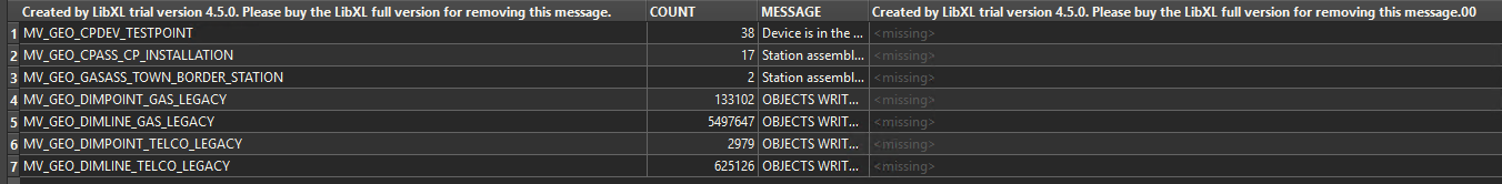

We upgraded our migration chain last week from FME 2025.0.1 to FME 2025.0.2 and our Excel writers started to mess up xlsx files. Some column names are renamed and hundreds of them added all with the same name: "Created by LibXL trial version 4.5.0. Please buy the LibXL full version for removing this message."
Strange thing is that not all workbenches are messing xlsx files like in the screenshot. Some of them behave as before in FME 2025.0.1. I indeed find libxl.dll library in the plugins folder of FME installation and version is 4.5.0.0.

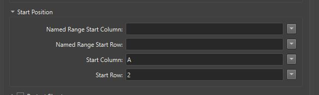

I changed the writer to start at row 2. It got rid of the message, then I just deleted the top empty row from beginning on row 2.
