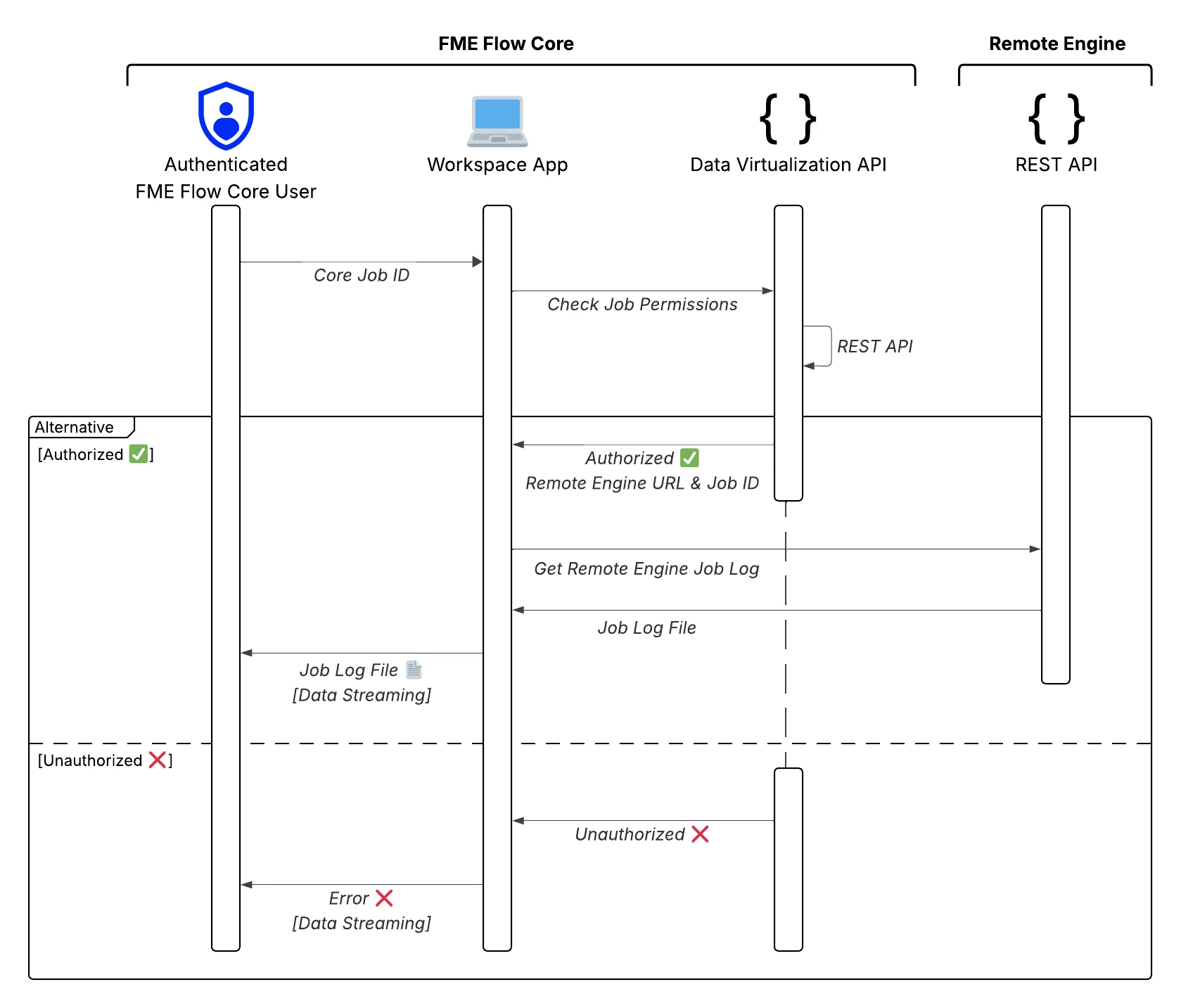

You can create an FME Flow Workspace App for a user to enter a core job ID, check their effective job permissions using a Data Virtualization API, and, if they have access, return the job log file using the Data Streaming Service.
What if the user doesn’t have access or something goes wrong? You can use the same Data Streaming Service to return an error to the user as HTML.
The diagram below illustrates the flow:
