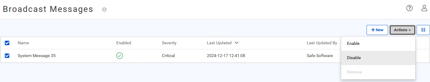

After you have patched, you will need to disable broadcast messages, made by Safe Software
Go to Flow > System Configuration and “Broadcast Messages”
Broadcast Messages

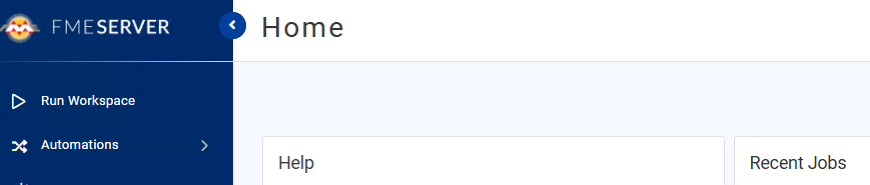

Rerun to home landing page, should be gone
