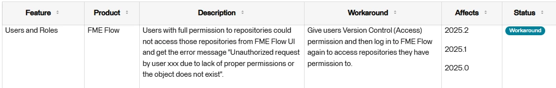

Hi Mike
Try to give those users Version Control (Access) permissions. This is a known issue since version 2025:
https://support.safe.com/hc/en-us/articles/34243509378061-Known-Issues-in-FME

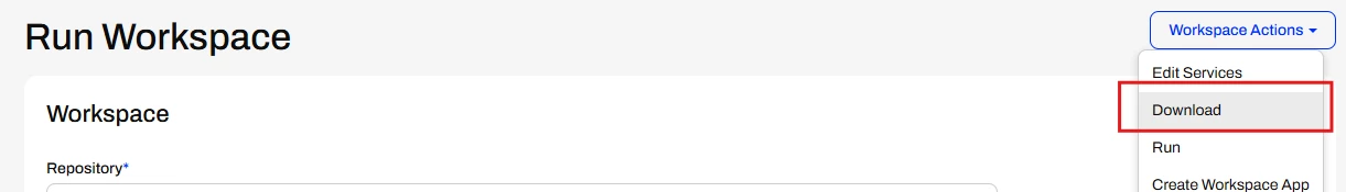

For the users with these roles in problems, we suggest to us to pass by Run workspaces to download .fmw.
Thanks, I overlooked this one! This seems to work for us.
