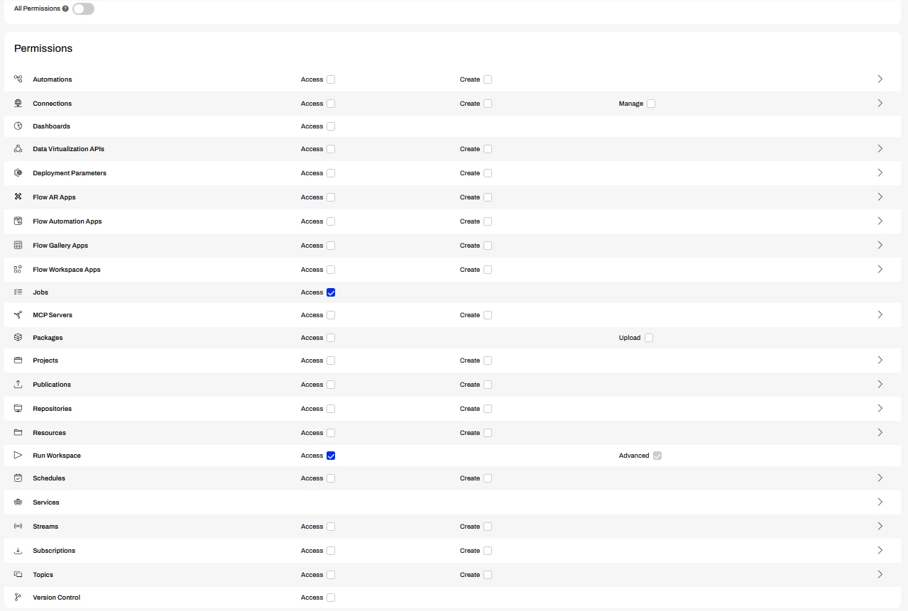

I'd like to retrieve running job details using the API. I use GET /jobs/{id} for this. This works perfectly when I assign ‘all permissions’ to the API-token. But when I try to make the scope more specific by setting the access right to Jobs-->Access, I'm not able to see the job details anymore. What are the minimal rights to make this possible?
I also assigned rights to a single repository and resource, but this is not visible on the screnshot.

In earlier version of FME Flow (2025.2.1) - Jobs has an access and a manage option. Access gave only permission to jobs you had submitted yourself. Manage gave you rights to jobs submitted by anyone (too many really, as often it is only wanted to view, not cancel etc.)

​@ebygomm , do you mean I miss any rights for my FME Flow useraccount to set de 'manage’ option, or do you mean that this option disappeared in FME Flow 2026?

I don’t know what is expected here. I don’t have FME Flow 2026, but I know that in 2025 just granting access to Jobs would not give the level of access you need for the api call.

Jobs -> Manage still gives you full access to the entire job history (all jobs from all users) in FME Flow 2026.2

Ok, thanks. So it is me missing rights to set the ‘Manage’ option. Too bad that it is not possible to limit the rights to the workspace you're trying to run.

If you set to “Access”, you can not access to a job run by you from a flowapp ? is it normal ?
You can see the job in the list but trying to get to the detial gives you “unauthorized request by user due to lack of permission”
