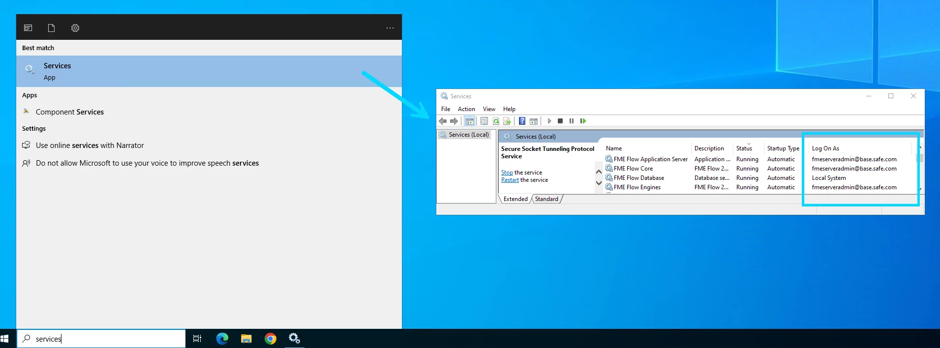

Hi ​@catherinep,
All files within the install directory <FMEFlowDir> should have the same permissions. Since it sounds like you’re on Windows, this is located at C:\Program Files\FMEFlow\ by default.
From our Permissions docs page, Read/Write permissions on <FMEFlowDir> are required for the account which runs the Core, Engines and Web App Server. You can check which account is running these in Services:
To ensure permissions are correct, you have two options:
  1. Paste in the patch files, and check each file’s permissions individually.
  2. Paste in all of the patch files, and set permissions (with inheritance) at the directory level.
We generally recommend restarting Flow after making permission changes.
Please let me know if you have any more questions about this! I’m happy to go into more detail if anything’s unclear.
