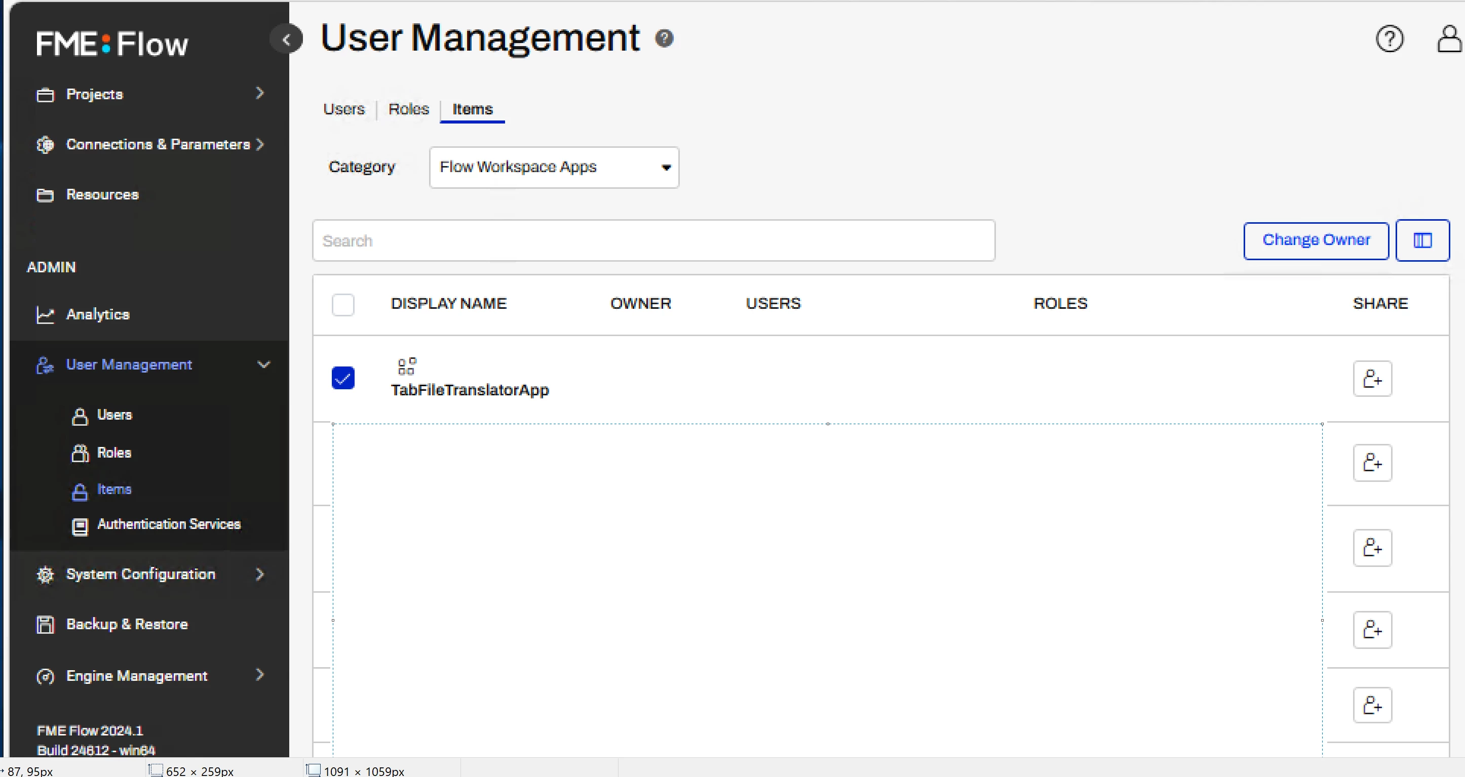

Ownership change is done under user management, items, not Manage Workspace apps

Why are you not able to alter the owner in UI?
I have just gone to user management > Flow Workspace Apps > Change Owner
and changed an owner in FME Flow 2024.1

  • Jun 17, 2026 3:13 PM UTC

Thanks David, I will try this as well.
For now I am just happy that I was able to transfer ownership via the UI. 😉
