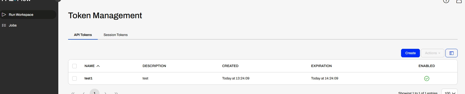

Here is an example of me making a token, using a admin login, to create a token for the guest and what is viewable under the guest login, and it inherits the permissions of what the guest account normally has (not the admins permissions).
Just need to make sure you take any security consiuderations into account.

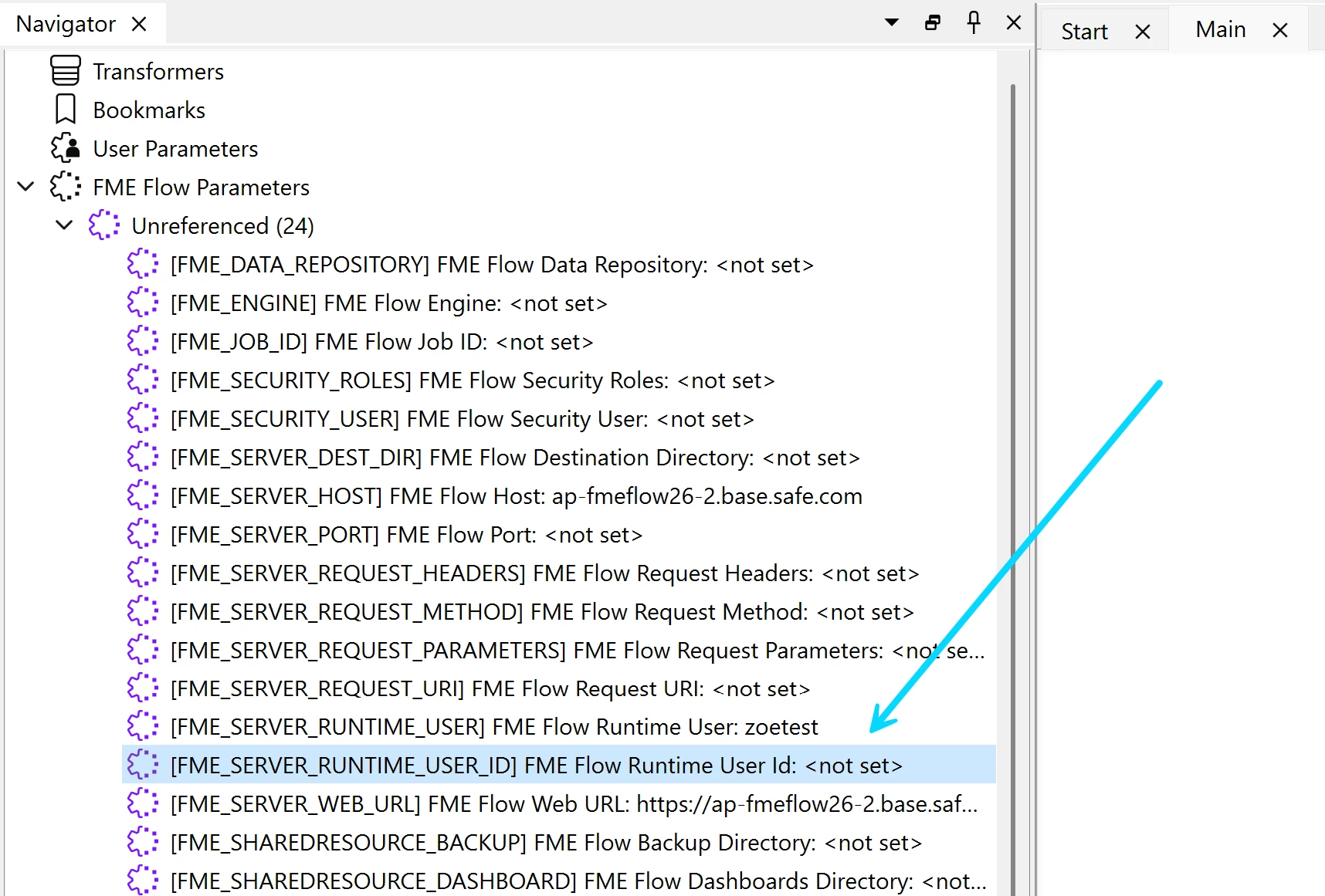

I agree with ​@todd_davis’ solution being a good approach! For others’ reference, you can obtain the authenticated user’s ID via FME Flow Parameters:
You can also save a transformer by setting a very short secondsToExpiry when creating the token, instead of manually deleting it.
