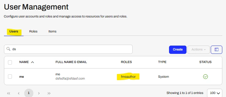

Are you using a System User, AD/LDAP user, or SAML user in Flow. Lets assume system user.
  • Users need to be mapped to Roles
    Users assigned to Roles

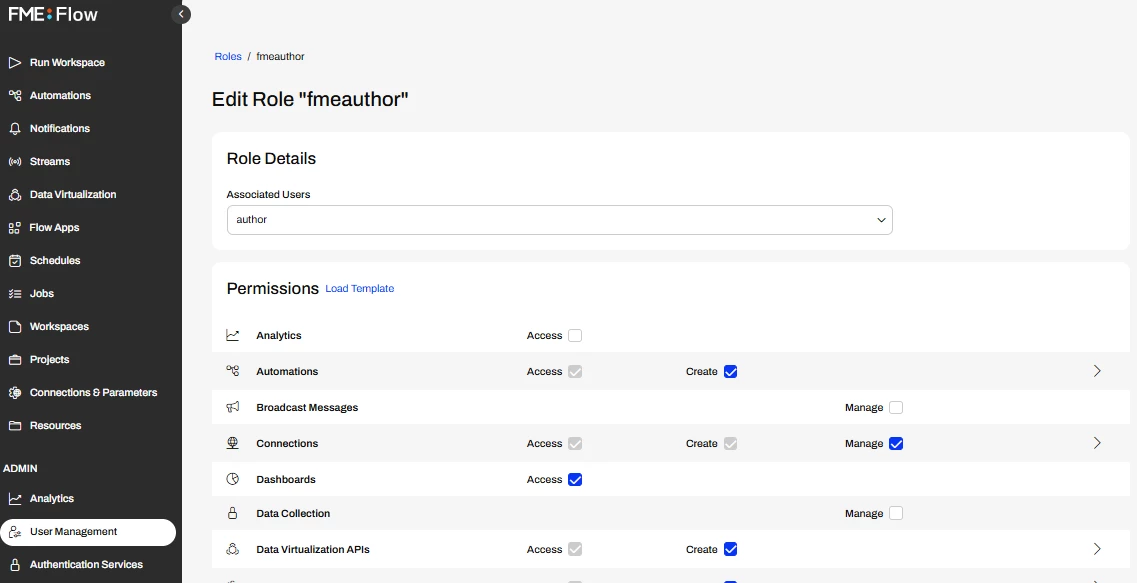

  • Roles need to have permissions to Connection = “Create”
    • you can even go further than create and set other permissions like Manage
  • Role Permissions
    Under manage, expand and check you have Run and/or Write permissions ticked
    Granting permission to sharepoint web connections
