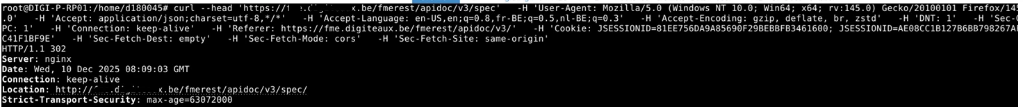

However, we are unable to use the REST API because an issue remains (see image in this email):
FME seems to expect its API to be contacted over HTTP (see image in this email), whereas we must absolutely communicate with **my.domaine.be** over HTTPS.

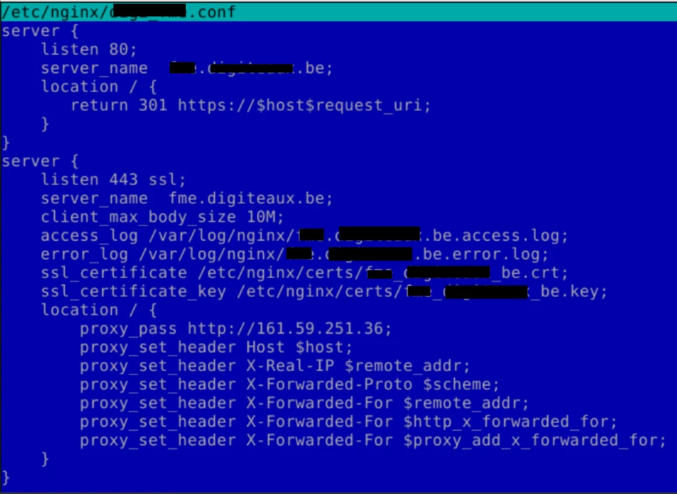

Could you tell us what needs to be adjusted in our configuration—whether at the proxy level (see attached configuration image), in the FME Flow settings via the web interface, or by modifying the FME Flow configuration files themselves?

In fmeFlowConfig.txt, is the FME_SERVER_WEB_URL value set to https?
