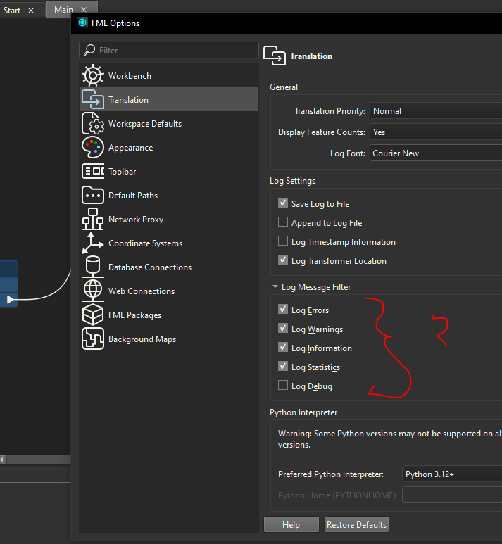

Hi ​@michaels I wonder if you can control that in the workbench settings? And if that doesn’t make a difference on the batch call then there must be a Set Warnings to false in the batch call.
Hope that helps.
