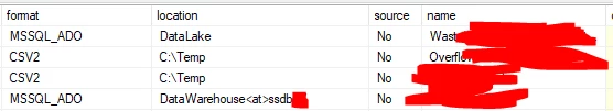

This gave me a clean, simple output showing the format, location, and name of each reader/writer, exactly what I needed for server analysis and metadata:

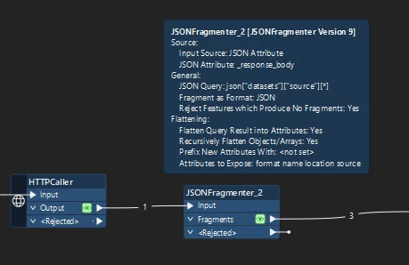

Have you looked at this API call
/fmeapiv4/workspaces/{repository}/{workspace}
Followed by a JSONFragmenter with the queries
json["datasets"]["source"][*]
json["datasets"]["destination"][*]

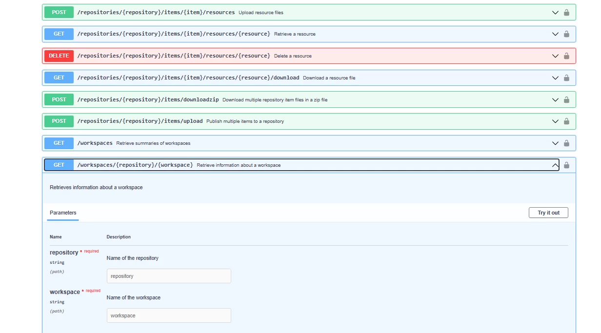

When I navigate to my locally hosted fme api v4 documents (at $(Environment_URL)/fmeapiv4/docs/index.html#/) there actually isnt mention to /workspace/ endpoint! but when I use it as you suggested, I can reach that endpoint.

  • Apr 15, 2026 10:13 AM UTC
On the API endpoints page, it’s listed in the repository section
