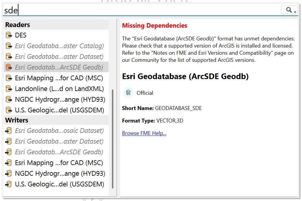

Hi,
I am using FME workbench 2024.1 to read an SDE database, every ting looks good, but tables can not be loaded. SDE database works in ArcGIS Pro, and the testing data connection in FME are also good. Anyone has experienced the same?

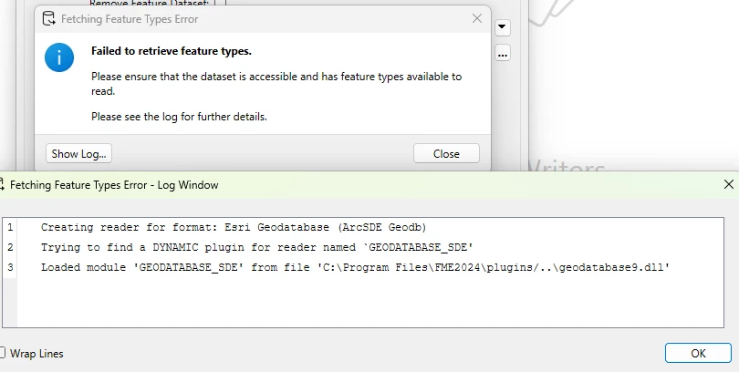

hkingsbury
Forum|alt.badge.img+73
  • Aug 4, 2025 8:57 PM UTC
Even though its truncated, does that DLL actually exist somewhere in the plugins folder?
I’ve had experiences in the past where overzealous security policies have cleared out portions of the libraries used by FME
fiona1112
Forum|alt.badge.img+4
  • Aug 5, 2025 9:04 AM UTC
You are right, the DLL file is missing. Do you remember how did you fixed it?
I have this file in FME 2023 version, can I reuse it? and the sde in FME 2023 is no longer can be used anymore.
rahulsharma
Forum|alt.badge.img+12
Hi ​@fiona1112
To Summarize on your system you have the following
ArcGIS Pro 3.3.1
FME 2024.1
FME 2023.x (previously installed)
After upgrade, Esri formats (ArcSDE and File Geodatabase) are not enabled.
Previously working with FME 2023
I would require additional information to try to troubleshoot this further.
Did you upgrade only FME or ArcGIS Pro as well?
Do you have multiple Esri application installed on your system i.e. ArcGIS Pro, ArcGIS Desktop etc?
Have you review this article to ensure that you have met all dependencies? FME and ArcGIS Pro
Is ArcGIS Pro using Named User license or Floating?
Also if you have any Antivirus or other software that may be blocking the access to the FME.
see https://support.safe.com/hc/en-us/articles/25407673805581-FME-and-Antivirus-Software
hkingsbury
  • Aug 6, 2025 9:51 PM UTC
We had to reinstall the software, after working with IT to ensure the files wouldn’t be flagged/removed again
fiona1112
  • Aug 7, 2025 6:26 AM UTC
Hi ​@fiona1112
ArcGIS Pro 3.3.1
FME 2024.1
Only FME was upgradetet this time, and I have only ArcGIS Pro with Named User License i my system.
I suspect that because the strict IT policy. Thank you for suggestion :).
