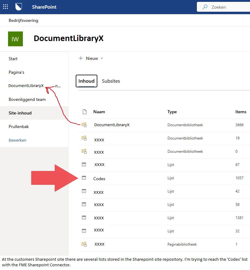

My colleague can access a specific list in Sharepoint itself (Codes)

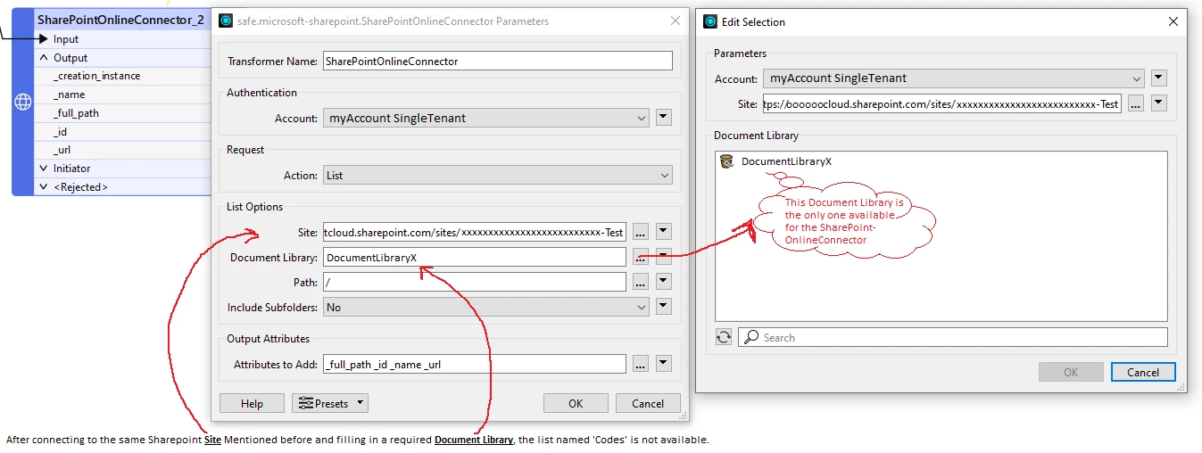

In the SharePointOnlineConnector, after connecting to the same Site, the list Codes is not available to him. Codes is a List and not a Document. Maybe that might be the reason why Codes is not available?

Hi ​@joy, have you tried the SharePoint List Reader? Are you able to read in your lists that way?

If I want to read out lists, then I need to use the SharePoint List Reader specifically?
I tried to use the Sharepoint ListReader just now, but then I encounter the same problem as in Connect to SharePoint list in FME 2020 | Community Web connection is empty and If try to make one, I get the following error
AADSTS70011: The provided request must include a 'scope' input parameter. The provided value for the input parameter 'scope' is not valid. The scope https://[TENANT].sharepoint.com/.default offline_access is not valid. The scope format is invalid. Scope must be in a valid URI form <https://example/scope> or a valid Guid <guid/scope>.

Yes! The SharePoint List Reader (and Writer) is designed to specifically read (or write) out lists in SharePoint.
To create a web connection, I recommend this article that walks through the steps to creating a single tenant Connection:
The article makes use of a Microsoft SharePoint Online template web connection, which I believe will help address the error you’re experiencing.
Besides that, our Getting Started with Microsoft SharePoint article has great additional information and more resources, like links to a multi-tenant setup
I hope these help! 🙂
