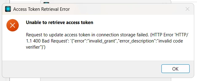

I have been following this article https://support.safe.com/hc/en-us/articles/25407494166029-Connecting-to-Salesforce-in-FME but am getting this error “Request to update access token in connection storage failed. (HTTP Error 'HTTP/1.1 400 Bad Request': '{"error":"invalid_grant","error_description":"invalid code verifier"}')” when I test the connection

Hi ​@londonwalker! That invalid code verifier error sounds like PKCE is in the mix, and that there’s a mismatch between what FME is sending and what Salesforce is expecting.
Edit:
The Connecting to Salesforce article has been updated with a Troubleshooting section that covers this. When setting up your Web Service in FME under FME Options > Web Connections > Manage Web Services, make sure to set the Code Challenge Method to SHA-256 and confirm that both the code verifier length and state length are non-zero.
Give that a try and let us know how it goes!
