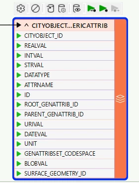

When you ‘open’ your writer in your workspace are those attributes listed?
Like this:

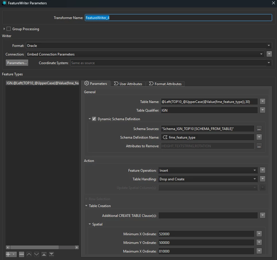

I finally managed to delete them using the ‘attributes to delete’ option in FeatureWriter (using the names defined by Oracle, i.e. HEIGHT, ROTATION and TEXTSTRING, rather than the format attribute name (fme_…)), but I still don’t understand why they were created automatically in Oracle.
In my external schema (CSV file), I do not define a geometry_type (as this does not work; I get an error stating that the geometry I entered is invalid, even though my geometry was ‘fme_point’). Could the fact that I haven’t defined this geometry and have asked FeatureWriter to set GEOM = all in the attribute parameters be the cause?
When I write the data by unchecking the dynamic point and therefore define the attributes in the FeatureWriter, these 3 attributes are not written.
There are therefore several possibilities:
- As the external schema does not define the geometry, Oracle may be creating these three columns in anticipation
- Could the dynamic use in a FeatureWriter instead of a standard writer be causing this? (I need a feature writer because I need an output port to add transformers after the writing).
Here are parameters for the featurewriter
