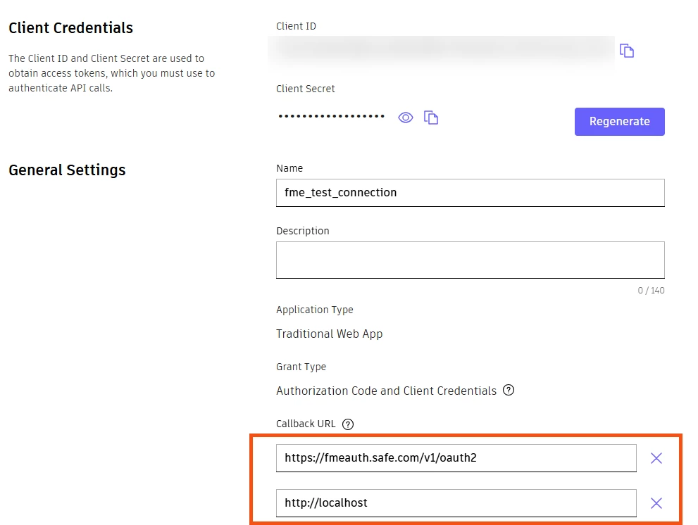

Hi ​@danii,
Thanks for raising this question! The reason you’re no longer seeing an option to set a custom redirect URI is that it was only an option in the embedded browser, which is deprecated as of FME 2026.2 (in favor of the external browser).
You or whoever manages your Autodesk Platform Services App registration will need to update the Callback URL to one of the Redirect Strategy URIs you’re seeing in FME:
For a full breakdown of the External browser change, including the redirect strategies, check out the External Browser Authentication in FME Form article.
