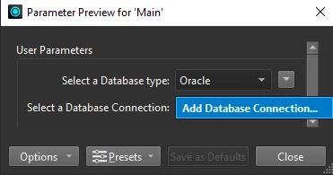

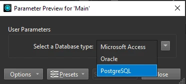

With some work you can make the following:
  • A choice list parameter with all the database types you want to use
  • A conditional visible Database Connection parameter based on you choice in the list of the previous parameter.
You could make something like this:
The Choice list parameter
Which then gives you a Select database parameter based on previous selected type. Prepared/existing Database connections are visible here

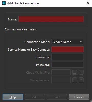

Add database connection opens the database connection designer for the selected database
