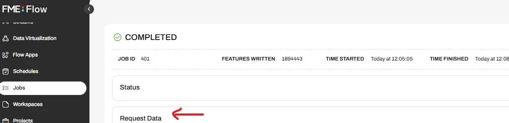

UI method
Under Flow > Jobs - find the workspace you run and open log
Under the “Request Data”
Job request info
You will find the Deployment Parameters section, refer to the VALUES

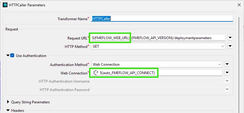

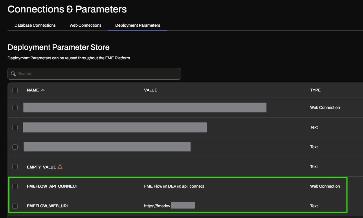

The solution that I’m using for now is to create Deployment Parameters on each of my FME Flow instances to return the instance URL and a web connection to connect to the instance.
I can then use these Deployment Parameter values in the HTTPCaller in my workspace to make the REST API connection:
I configure the FMEFLOW_API_CONNECT web connection with appropriate permissions for accessing the API calls that I need and I’ve created a specific user that is defined in the web connection. However, it would be nice if this could just use the currently logged in user in FME Form, without needing to create a custom user on FME Flow to achieve this.
